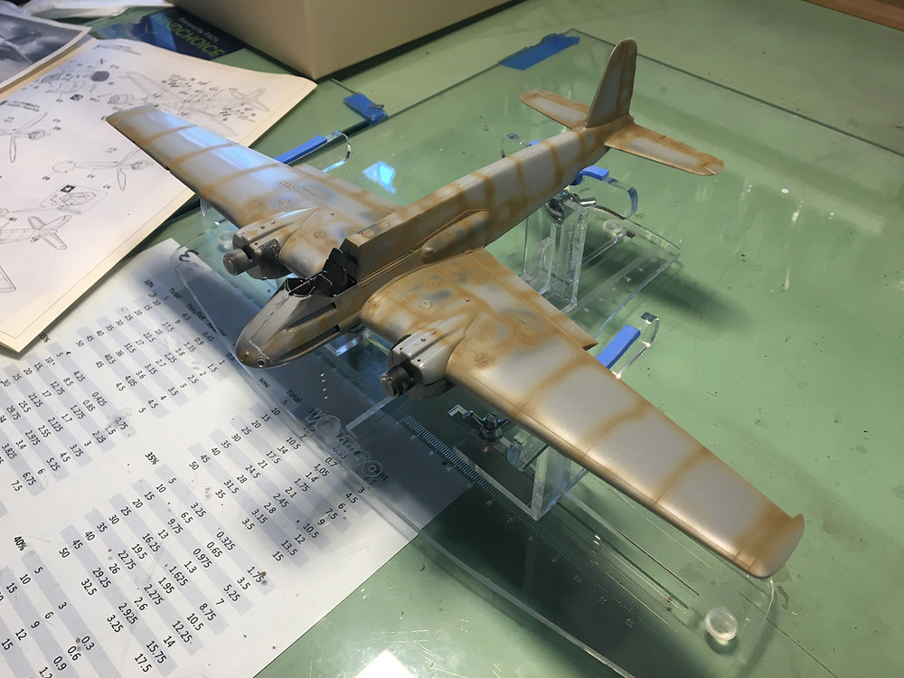

The kit, the box art is top notch. My progress. It will be box stock. I am trying to pick-up my build pace a bit. I have eliminated base coating and applied Alclad directly to the styrene. I only applied Alclad to areas of the airframe I plan on chipping. The top photo shows where I am presently. Alclad applied to to leading edges of the wing, engine cowls, walkway, cockpit edges, armament service doors, fuel filler caps and leading edges of the tail planes. Ammo by MIG scratches fluid has been applied to those areas that have Alclad applied. Some pre-shading on the upper surfaces has been completed.

I spent some time 'splotching' RLM80 over the RLM79. Photo 1 shows just the top coat over the panel line pre-shading and splatter stenciling. The splatter pattern is very subtle and looks good, especially in person. I did the splotches, unintentionally, in two phases. The second and third photos show the populating of splotches on the aircraft. Photo 2 shows the first application of the splotches using a paint stencil. I thought that the number of splotches was all it would require. I got to looking at the results but was not satisfied based on era photos of the 129 and other german aircraft in desert camo. Photo 3 shows the additional splotches. Doing the splotches in 2 phases, it allowed the first application to dry before the second application, thus not smearing the first splotches. Next, chipping reveal and un masking.
Although it's hard to see well, I like what I can see of that splatter stenciling! Splotches look good too, and makes sense to do in multiple passes to keep from smearing - good tip.
